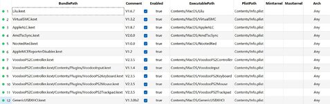

On your forum I did not find GenericUSBXHCI.kext in the download section and therefore downloaded from this site: https://bitbucket.org/RehabMan/os-x-generic-usb3/downloads/
I put it in the kexts folder, added it to config.plist, reset NVRAM, but it still hangs on the same line
Bam. It's here
The Rehabman's fork will NOT work in this case its not supported on Ryzen ;)
Try the above kext and update the thread. Hopefully, you should be able to boot the installer.
Oh no, it didn’t help again... I don’t understand what the problem could be 20231126_185701.jpg
I don’t think there could have been an error when adding kext, I added it using the plus sign in the program BGtetlhoQZo.jpg UPLuLh0Lui8.jpg
Load it after AppleMCEReporterDisabler.kext.
