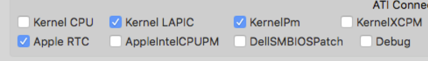

There's a section that describes kernel and kext patches for the CPU. In the guide it is stated that:
The following options needs to be checked
  • AppleRTC
  • AppleIntelCPU
  • kernelPm
But on the screenshot below there are different options set:
Which one shall I use?
Thank you
Thanks for notifying to me. The screenshot is correct. I'll fix it.
