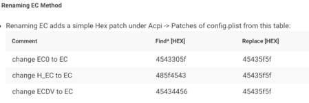

Ok, I originally only had the first two patches. I got the third one from this guide: https://www.elitemacx86.com/threads...-gaming-3-wifi-intel-core-i5-9400f-rx580.421/
I've now removed the third patch, all the USB ports continue to work just fine with just two patches (as you can see on the image above).
HDAS to HDEF rename.
This was "disabled" on my config.plist. I've enabled it now (you can see on the image above).
