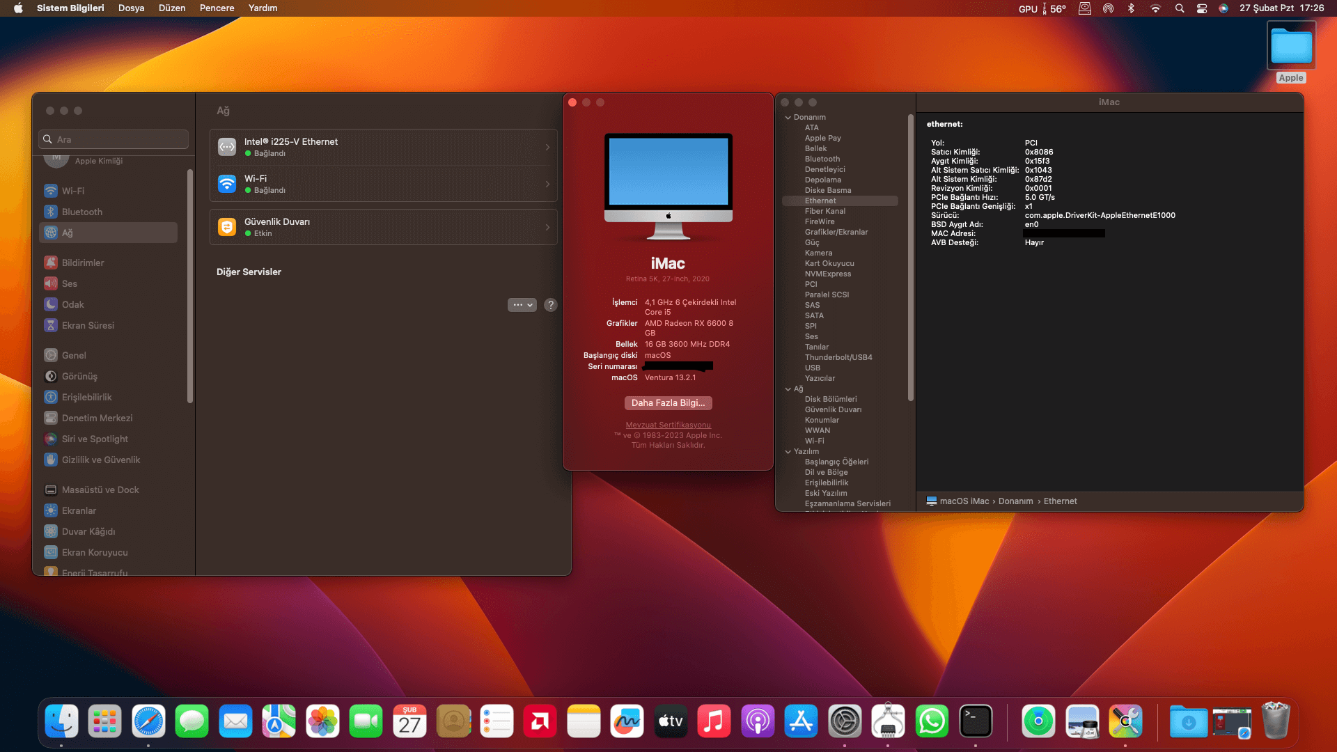

Intel i225-V: In Boot arguments: e1000=0 I tried running ethernet with AppleIntelI210Ethernet.kext, but I got an “in memory panic stackshot succeeded” error at boot time. I deleted the kext from EFI/OC/Kexts and also removed it from OpenCore. I also completely removed the fakepciid.kext and fakepciid_intel_i225-v.kext kexts as they no longer support Monterey and Ventura. As a result of my research, I had some observations that the problem was fixed with AppleVTD and I read [URL='https://elitemacx86.com/threads/how-to-enable-apple-vtd-on-macos-clover-opencore.868/']the How to Activate AppleVTD[/URL] guide. After completing the AppleVTD process, [URL='https://github.com/5T33Z0/OC-Little-Translated/tree/main/00_ACPI/ACPI_Dropping_Tables']Dropping ACPI Tables[/URL]I added the SSDT-DMAR.aml file to EFI/OC/ACPI considering the guide and activated it from OpenCore. Some articles have been written about modding the i225-V in some forums, but I never needed modding. By removing the aforementioned kexts, I applied two ways and I had no problems with ethernet, then ethernet gained great stability.
