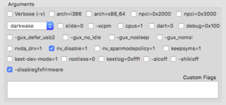

  1. Navigate to Boot tab and check the following :
  • Check -disablegfxfirmware box
  • Check nv_disable=1 box
