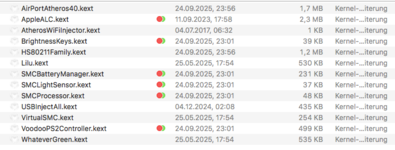

Meanwhile booting in normal mode works, ethernet with an old kext and WiFi with AirportAtheros40.kext, AtherosWiFiInjector.kext and HS80211Family.kext, all 3 were necessary. Even the brightness keys are working with that kext, they never did with Mavericks and earlier. Sleep is not working yet nor is sound, sometimes there are glitches on the display and random freezes. Updates from the Appstore are not working, I can live with that. Here is a screenshot of my kexts. I'm still booting from an USB drive until everything works.
