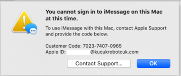

VMs are not that kind of load what I am talking about an example is not being able to click with a mouse after using two finger(one that simulates right click) gesture. The reason I said disaster is about SMBIOS has valid serial numbers that's why iMessage does not work.It requires invalid serial numbers created by
clover configurator.
5. Facetime does not work (some internal error message), Looking into that, I think i can fix that on my own, just mentioning here for completion.
It turns out it is generally caused by EmuVariableUEFI it should be deleted for that. If you have an NVRAM problem fix is a lot more different.
