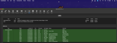

When I enable TB type-C, I get this in the tool bar, It's for powering off USB controller. I'm sure it's something I've done wrong when mapping usb ports. I can hide it by dragging it off while holding win key but it comes back when I reboot. How do I hide it permanently ?
Oh BTW the only way I could get the OC 1.0.6 update to work was to update everything but HFS and Open Runtime the drivers. (not sure what that's about)

Got only one issue that I have yet figured out. I have everything but AirDrop working. I can receive and see my other devices but can't send anything. I've read up on every solution (fix) I could find with no luck. Can you please take a min to see what I've missed/overlooked? Running Ventuura
First, when you're using DSDT, then you should drop the OEM tables. Same for the other OEM SSDTs as well.
If your WiFi is natively supported, then remove the device properties for it. What's your WiFi model?
Why are you using AppleALC and AppleALCU together?
Enabling XhciPortLimit defeats the purpose of having USBPorts.kext.
Enabling AppleXcpmForceBoost defeats the purpose of XCPM.
I just seen your reply, I had already used ACPI Extractor. Also had already disabled forceboost after noticing high CPU temps.
Just removed ALCU (it wasn't causing any sound issues that I noticed) Removed WiFi card from device properties. fenvi BCM94352Z
Everything seems to work the same. Still no airdrop but I can live without it.
