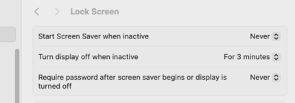

In Settings I go to Lock Screen and set Turn display off when inactive for 5 minutes.
After 5 minutes of inactivity monitor goes off.
I expect it to turn back on when I move or click mouse or press keyboard button.
But it does not.
It remains turned off and the only option is to restart computer.
