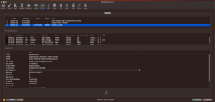

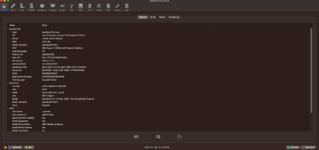

Provide a Desktop picture.

This is image:
Screenshot 2024-02-06 alle 07.51.44.png Screenshot 2024-02-06 alle 07.50.12.png Screenshot 2024-02-06 alle 07.50.43.png

According to the pictures, Graphics seems to be working.
