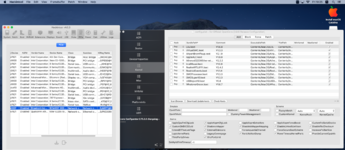

It works on Catalina, no patching. I just installed in on fresh drive, and Wi-Fi works as it should be. Just a strange thing that in Hackintool PCI e tab it shows as disabled.
So what should I do as the next steps? Try to use OCLP and from there move to Sonoma?

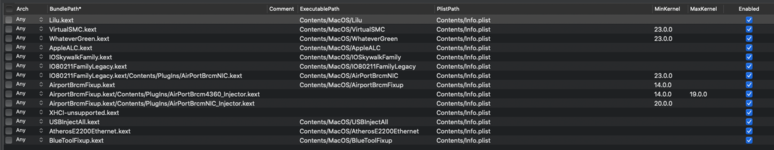

So installed Sonoma 14.2 using OCLP. I did check the folder with kexts before upgrading from Catalina to Sonoma.
This is Sonoma 14.2 OCLP made kexts:
What I did, I only use the necessary Wi-Fi kextes since rest of the things works just fine.
But the Wi-Fi isn't still working, so not sure what I did wrong. I think I will just stay at Catalina until I figure something out.

Create the EFI according to the guide first and then patch the WiFi. It will definitely work
The topic can be closed, I fixed with @EliteMacx86 guidance.
The setup should look like this:
