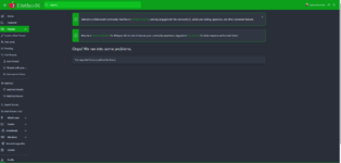

i spend my all day doning this now its not working even after disabling SIP as per guide OCLP is not showing option of patching.

Attach the config.plist to check.
