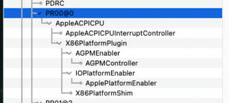

I found out that the complete intel power mangement is not working on my system - how to enable this?

Also, attach your copy of IOReg.
Ah, there we go. The reason for higher power consumption is here as the CPU PM is not working.

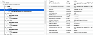

Did it in exactly that way - seems now to be active, or not? - but idle power draw still about 20W higher than windows 11 on my system
65W Hackintosh
45W Win 11
Also Intel Power Gadget doesnt show anything - I cant check the frequencies there
CPU PM seems implemented.
