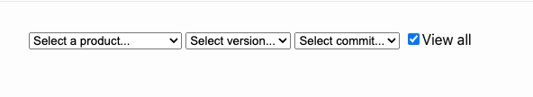

1. Visit the builds section.
2. Click on Select a product drop-down menu, and you'll find all the related products.
3. Select OpenCorePkg from the list and click on the Release button to download the latest OpenCore.
4. Like step 3, download the latest release for essential kexts like Lilu, VirtualSMC, WhateverGreen, AppleALC, CPUTscSync, and other kexts you need for booting your system.
