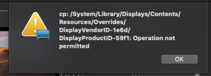

Whenever I try to create a new resolution scale on rdm I got this message? A little help would be appreciated on how to fix this issue.
thanks

Seems like you're trying to override.
Use the following command to enable HiDPI
bash -c "$(curl -fsSL https://raw.githubusercontent.com/xzhih/one-key-hidpi/master/hidpi.sh)"
I need some kind of command to override. The above method does not do anything. The boot screen apple is normal after reboot and Hidpi is not "enabled'
Plz Help!
Plz Help!
Enter the above command to enable HiDPI. Once enabled, you can use RDM to enable Custom Resolution. All previous work must be cleared.
I can do it with RDM, I jus need to override with the edit option, I tried a dozen time the above method. The cmd App does not do anything
check the screenshot
