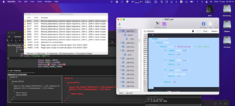

Help solve Missing dependency (Device object requires a _HID or _ADR in same scope) DSDT patch
oldman20
Member
Nov 6, 2021
141
Dell 3558
Broadwell 5200U
Intel HD5500
  2. OpenCore (UEFI)
I tried all my best but cant pass this, any suggest? thank so much
 Scope (_SB.PCI0)
        Device (SDMA)
            Method (_STA, 0, NotSerialized)  // _STA: Status
                If (LEqual (SMD0, 0x02))
                    Return (0x0F)
                If (LEqual (SMD0, Zero))
                    Return (Zero)
                If (LLess (OSYS, 0x07DD))
                    LPD3 (SB10, SMD0)
                    Return (Zero)
                Return (0x0F)
558101851_ScreenShot2022-08-17at16_39_14.thumb.png.a95c85a773849df4310c31ef223bb328.png

Which patch are you trying to apply?
DroOEM is a Clover option. Must be set to TRUE if you're using all the OEM SSDTs which have been patched. If not, do not use the DropOEM option.
Reactions: oldman20
must all OEM SSDTs, so if some SSDTs patched, no need DropOEM?
