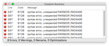

Use "Remove _PSS placeholders" patch to fix this error.
When using B0D3 to HDAU patch, for the SSDT (SSDT-7), you'll have 9 errors in total.
Simply replace BD03 to HDAU
