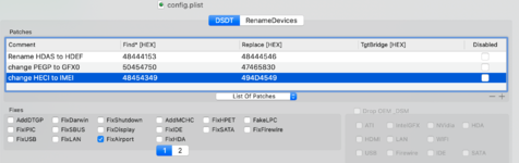

Done
  • Add HECI and IMEI renames.
I've added "change HECI to IMEI", now I have the following patches:

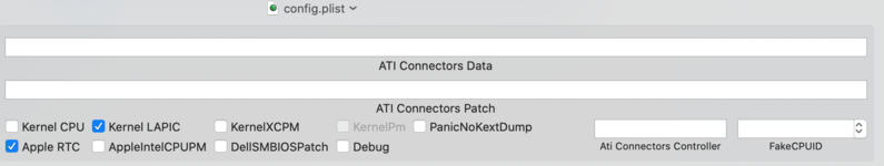

  • KernelPm is not checked. Check this option.
Thins one is interesting. I can't check this box on clover, its not enabled, as you can see here:
So what I did was to add it manually to the config.plist fine, the section becomes this:

However, every time after booting the OS, the "KernelPm" option gets removed from the config.plist, so it becomes like this after booting:
  <key>KernelAndKextPatches</key>
    <dict>
        <key>AppleIntelCPUPM</key>
        <false/>
        <key>AppleRTC</key>
        <true/>
        <key>KernelLapic</key>
        <true/>
        <key>KextsToPatch</key>
        <array>
Any idea why @EliteMacx86? My clover version is 5118.
