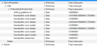

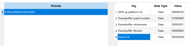

So I've got it working fine. The only issue now is that I'm not able to get graphics acceleration with the UHD 630.
My DeviceProperties is configured as this:
following this guide:
Also tried this config:
Do you have any idea?
Thanks
I've replaced the DeviceProperties with these ones but I get a black screen. Then I tried to add igfxonln=1 to the boot-args but it didn't work...

ASUS Laptops have option to set the DVMT to 64MB specifically. For such cases, you should remove the stolenmem and fbmem entry.
You're using different generation ig-platform-id and different generation device-id which is the issue. Your CPU is 10875H which has a 0x9BC4 Device ID which is natively supported. So, you just need to add ig-platform-id and enable framebuffer-patch-enable. The ig-platform-id should be 3EA50009 as per the guide.
