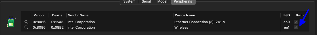

Hello everyone,
I would like to know how to deactivate my Wifi card ?
In the Hackintool software, I see that it is on buit-in and I would like to uncheck it
In opencore configurator / DeviceProperties / List of PCI Device
Once I have added my WiFi card, what should I enter please?
key -------- Value --------- Type
built-in --------- ? --------- DATA
what should I write in Value?
Thanks

That's automatically taken via the ACPI itself. You can override using a custom SSDT. But the question what's the problem if it shows built-in?

I have AirportItlwm.kext, le Wifi working perfectly, on Mac OS Monterey, I can use iMessage & FaceTime, everything is perfect.
I installed Sonoma 14.4, I took the Kext for Sonoma, everything works perfectly but I can't use iMessage & FaceTime.
iCloud works
( https://github.com/OpenIntelWireless/itlwm/releases/tag/v2.3.0-alpha )
AirportItlwm-Sonoma14.4-v2.3.0-DEBUG-alpha-6dc344d.zip

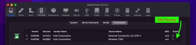

When I use the Hackintool software, I noticed that the Intel Wirless 7260 Wifi card is checked with Mac OS Sonoma 14.4 and that on Mac OS Monterey, the Wirless 7260 Wifi card is unchecked.
I tell myself that maybe this is the problem that is preventing me from having the iMessage & FaceTime services?
When I use the RJ45 cable, the iMessage & FaceTime services work perfectly.
I want to do a test but I don't know how to uncheck the WiFi card like on the Monterey screeshot.

PS: I just tried itlwm.kext with Heliport and iServices works ^^
So I checked hackintool and the Wifi card is unchecked.

Good find. Will have to experiment and update the thread accordingly.
