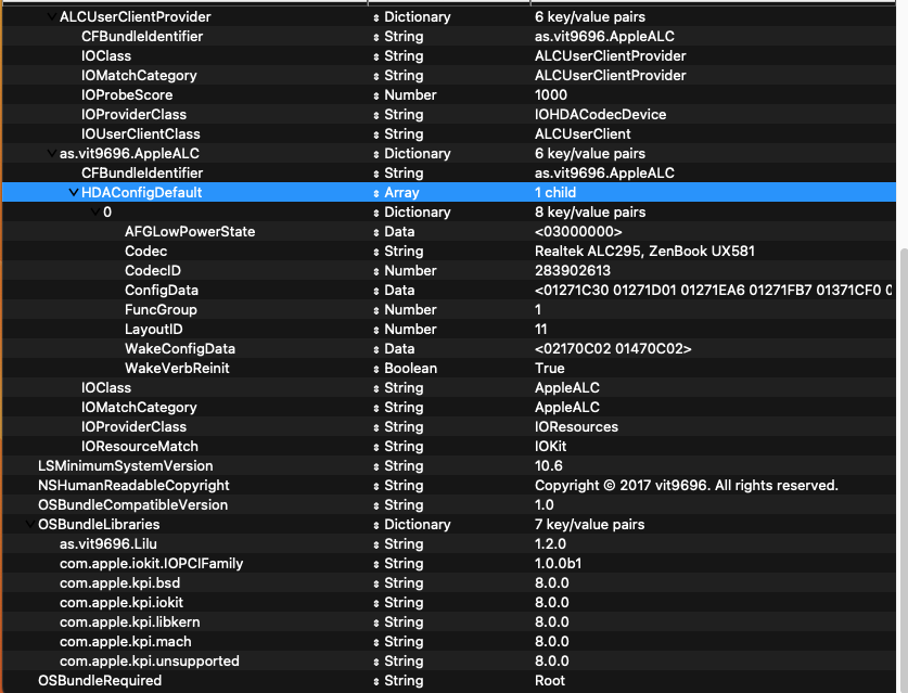

Today I created this Topic to ask for everyone's help in Fixing Headphones with ALC295. I have tried all the layout-ids and I have compiled them all in the following picture:
Like the photo above. Currently only layouts 3,11,24 have sound when headphones are plugged in. but lost the Speaker or Mic. I searched a few forums and found the following macOS daemon tool:

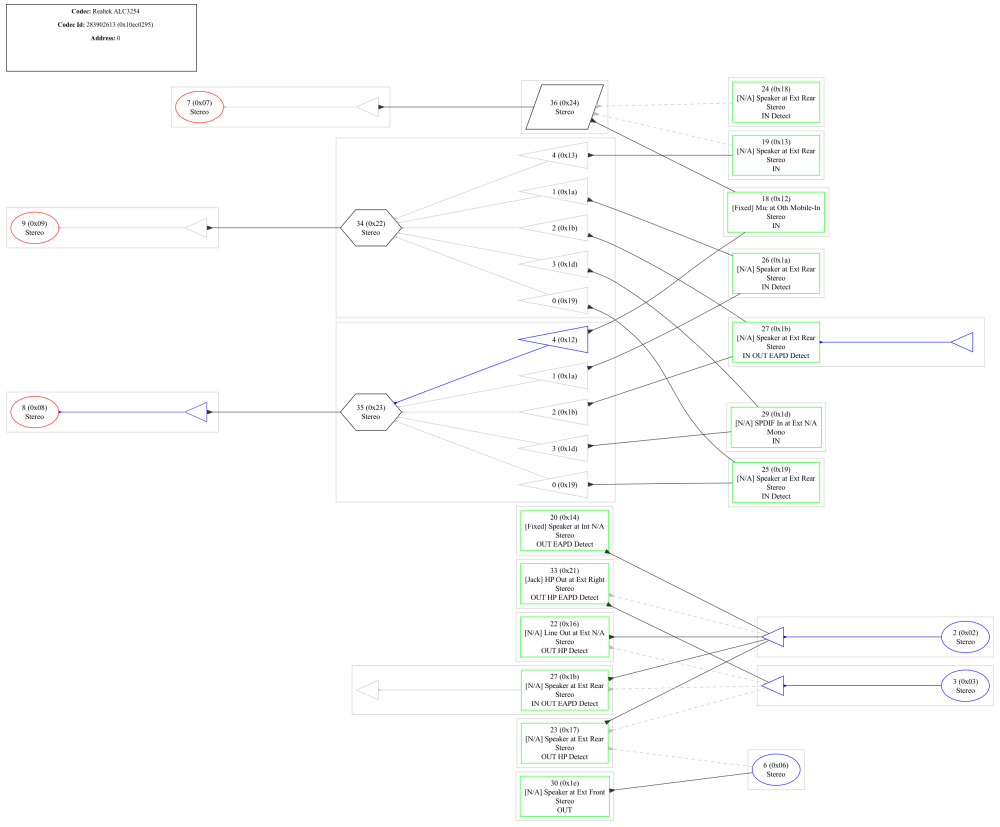

I followed this page: https://github.com/5T33Z0/AppleALC-Guides/tree/main/AppleALC_Layout-ID to Build Layout-id, to understand the steps to build AppleALC kext and to understand it too. Followed the above guide and I dumped codec_dump.txt containing information about my codec and codec_dump.png a visual representation of the data inside the codec dump:
codec_dump.txt Original codec_dump
Codec-Dump-Dec.txt Version convert Node from Hex to Decimal
And a visual representation of the data inside the codec dump:

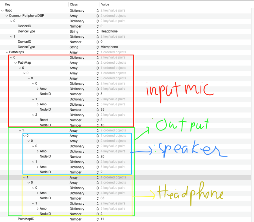

I tried reading the above diagram in combination with opening Platform11.xml and Platform77.xml for comparison and realized that:
- Int Speaker is: 20 - 2 ( in 77 )
- Headphones: 33 - 2 ( in 11 )
- Int Mic: 8 - 35 - 18 (in 77)
So I edited Platform11.xml as follows:
I then edited Layout 11.xml like this: ( combine Layout-id 11 with Layout-id 77 )
