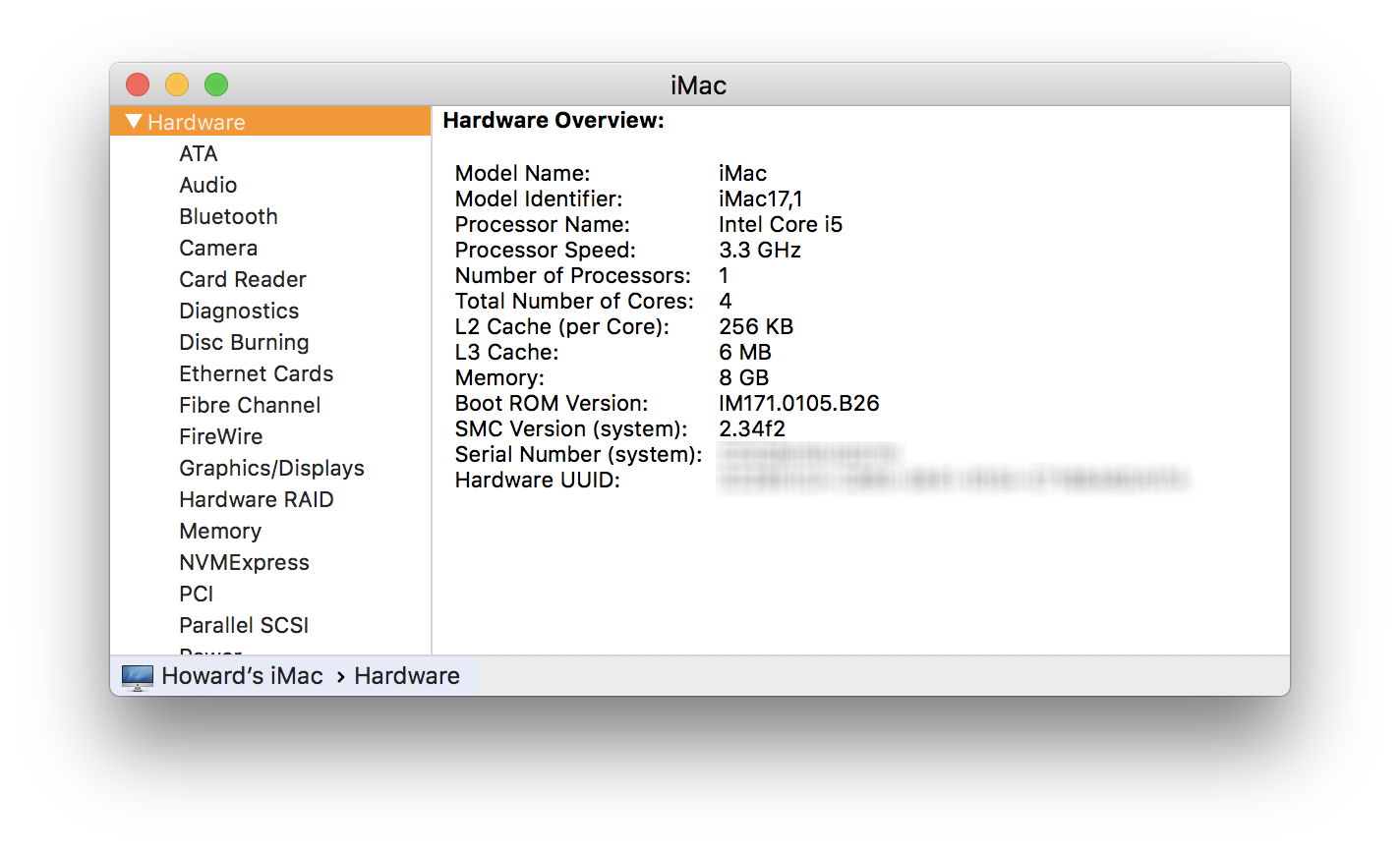

- Can you please explain to me how I check if the firmware is up-to-date or not?
