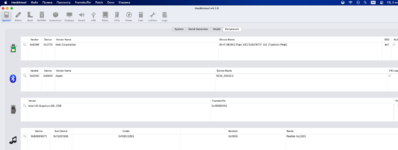

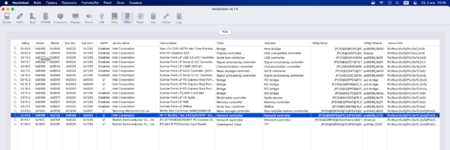

Some of you might suspect that it could be possible that the WiFi isn't detected but that's not the case. As you can see the Hackintool does recognize the WiFi and despite the WiFi kext being injected, the kext doesn't load and as a result, the WiFi does not even start on a hardware level. Unless the hardware is initialized properly, the kext won't load and the device will not work.
