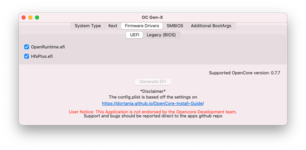

4. Once you're done with Kext Tab, click on Firmware Drivers and select OpenRuntime.efi and HfsPlus.efi.
Screen Shot 2022-06-07 at 12.35.59 AM.png 5. After Firmware Drivers, move to SMBIOS Tab and select the System Model close to your CPU model and click on the refresh button to update the data.

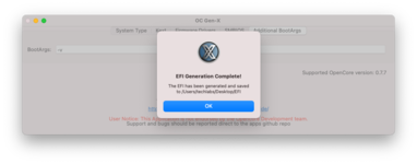

7. Once you're done with the above steps, simply click on Generate EFI and the EFI will be generated at your Desktop
