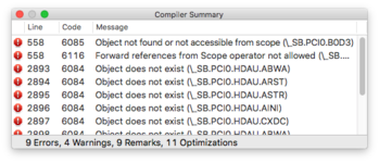

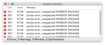

Use "Remove _PSS placeholders" patch to fix this error.
When using B0D3 to HDAU patch, for the SSDT (SSDT-5-HSW-LPT), you'll have 9 errors in total.
Simply replace BD03 with HDAU

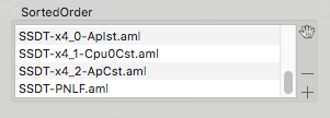

1. Open your config.plist
2. Check "Drop OEM"
3. Under Sorted Order, list all of your DSDT and SSDTs.
The SSDT (SSDT-PNLF.aml) should be added at last.

- Remove _PSS placeholders
2. Check "Drop OEM"
